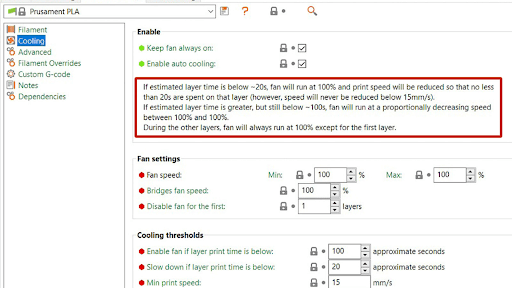

Cooling settings in PrusaSlicer
In PrusaSlicer, the cooling settings are quite simple and easy to access. It lets you adjust the cooling settings for each filament type. There’s a nifty option called “Keep fan always on” which will make sure the print fan maintains at least a minimum speed throughout the print.
This setting is typically turned on for most materials except for a few like ABS, PC, and some flexibles where cooling needs to be controlled​​.
Under the Filament Settings tab, you can set the specific settings for the filament like temperatures and cooling, making it a breeze to set up your cooling settings for different materials​.

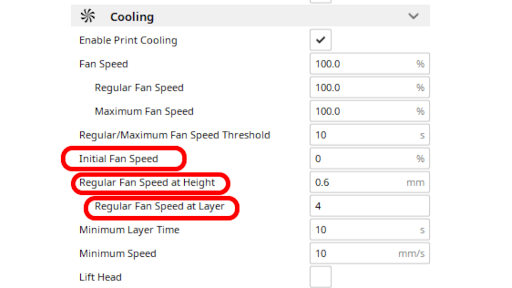

Cooling settings in Cura
Cura is known for its super user-friendly and easy to use interface that comes with. extensive. customization options. Just like in PrusaSlicer, you would find settings to adjust the fan speed according to the material you are printing with.
You can set a different fan speed for the initial layer to get good bed adhesion, and then ramp it up for the rest of the print to cool the material properly as it lays down.
Both slicers provide complete control of your cooling settings, making sure that each layer of your print gets the cooling it needs to solidify properly before the next layer comes in.

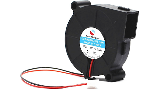

SoundOriginal 5015: This fan is a stellar choice if you’re looking to beef up the cooling on your Ender 3. It’s a blower fan, which means it can push a good amount of air to keep your prints cool as your printer prints.

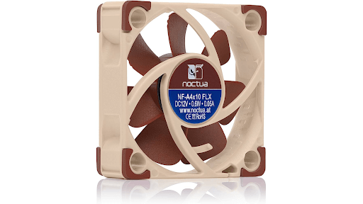

Noctua Fans (NF-A4x10 FLX & NF-A4x20 FLX): Noctua fans are the silent fans of the 3D printing world. They operate quietly, make sure that your printer stays cool without adding to the noise pollution in your space​​​ and they’re much more powerful than a stock fan.

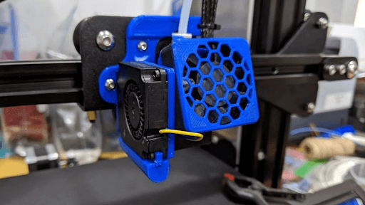

Cooling Mods
Sometimes, a fan upgrade might not be enough, and you’d need to modify the cooling system a bit to get the desired results. Satsana Ender 3 Fan Duct is a neat and compact fan duct for Ender 3 that directs the airflow exactly where it’s needed.
By upgrading the Ender 3-part cooling fan with a new fan and a 3D-printed cooling duct. You can have the airflow optimized for better cooling​​.
Upgrading the fans and printing fan ducts not only gives you good printing quality but the silence that comes with a good fan upgrade is more than anything, and the improved cooling performance is just the cherry on top.

If you’re an Ender 3/3V2 user, you might notice that the stock cooling fan doesn’t cool properly, especially for overhangs and bridges. Consider upgrading to a more powerful fan or even a dual fan setup for better cooling performance.
Satsana Ender 3 Fan Duct could be a good fan duct upgrade for your ender /3V2 as it cools the filament from both sides and you can use a more powerful fan like SoundOriginal 5015 as a blower fan and  Evercool EC4010 blower fan as a part cooling fan.
