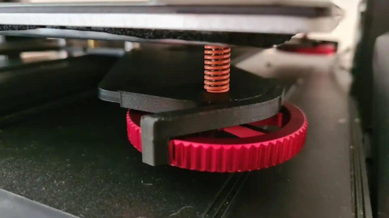

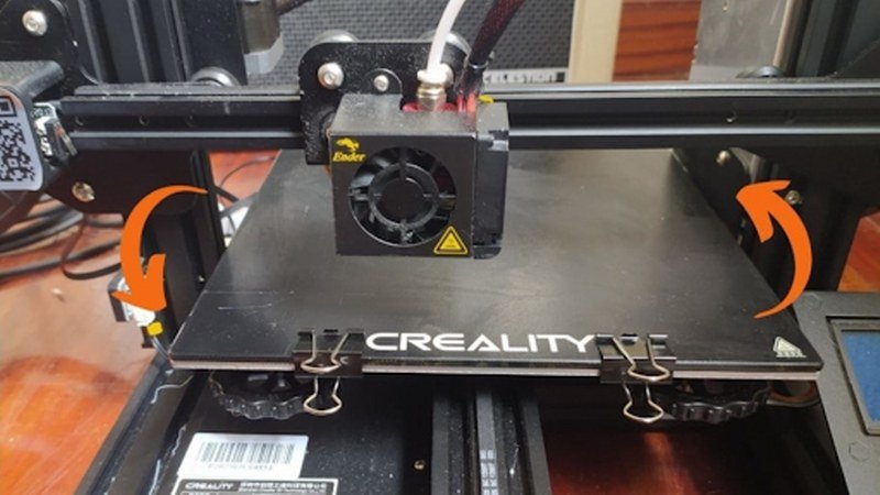

Adjust the corners
  • Take a standard piece of printer paper and slide it under the nozzle at the front left corner.
  • Gently turn the leveling knob until the paper slightly catches on the nozzle. You should feel a bit of resistance but still be able to move the paper.
  • Repeat this process for all four corners, going in a circular pattern.
Check the middle
  • After leveling all four corners, it’s important to check the middle of the bed. If the middle is off then you’ll need to readjust the corners.
Test it out
  • Finally, run a test print. Observe how the first layer adheres to the bed. If it’s uneven, you may need to go back and make minor adjustments to the leveling knobs.

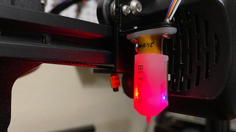

Automatic bed leveling, also known as ABL, is a more advanced method that involves using a probe to measure the bed’s flatness automatically. The printer then compensates for any unevenness during the print. This method is less hands-on but can be more precise.
For this guide, we’ll be using the BLTouch probe for its reliability and precision. Here’s how to install this and run it:
Step 1: Choose a probe
  • First things first, you need to pick a probe for auto bed leveling. For Ender 3, BLTouch is a popular and reliable choice.
Step 2: Get a mount for BLTouch
  • You’ll need a mount to attach the BLTouch to your Ender 3. You can either buy one or 3D print it yourself. Here are some links to 3D models suitable for this purpose. Links to the file are given below:
    1. Ender 3/ 3 Pro Mount 2. Ender 3 V2 Mount
  • Set Y and X offset according to mount, Offset numbers are given in the description of these STL files
Step 3: Install the pin 27 adapter board
  • Turn off and unplug your Ender 3.
  • Open the electronics enclosure.
  • Ender 3’s controller board doesn’t come with a direct plug for the BLTouch. So, to connect the BLTouch to the Ender 3, you’ll need a Pin 27 adapter. First, unplug the display ribbon cable from its port on the motherboard.
  • Plug the Pin 27 adapter into this port and reconnect the display to the adapter. Finally, connect the BLTouch wires to the pins on the adapter. Make sure everything is secure before closing the motherboard cover.

Step 5: Wire the BLTouch
  • Connect the BLTouch wires to the Pin 27 adapter board.
  • Follow the wiring diagram that comes with your BLTouch kit.
Step 6: Calibrate the BLTouch
  • Navigate to Control > Auto Home on your printer’s menu.
  • Move the nozzle to the center of the bed.
  • Lower the Z-axis until a paper can barely pass between the nozzle and the bed.
  • Note the Z-axis value and enter it in Control > Motion > Z-Offset.
  • Save these settings by going to Control > Store Settings.
Step 7: Run the ABL procedure
  • Send the G-code command G29 to initiate auto bed leveling.
  • Save the leveling data by going to Control > Store Settings or send the G-code command M500.
