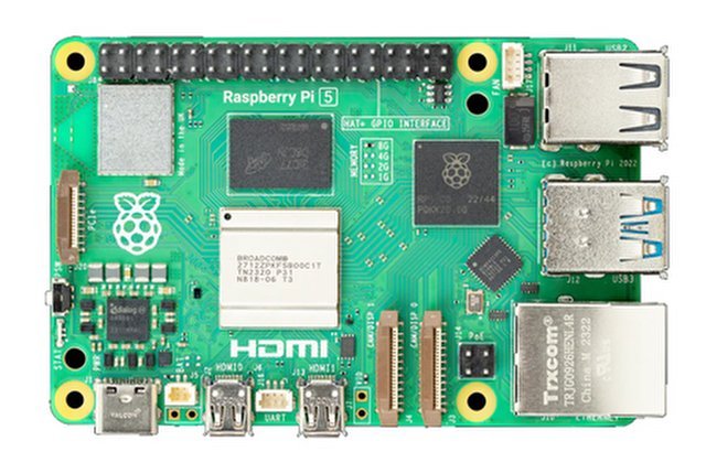

If you’ve just unboxed your shiny new Raspberry Pi 5, one of the first things you’ll notice is that familiar 40-pin header sitting proudly on the board. That’s the GPIO header — basically your Pi’s way of talking to the outside world.
Raspberry Pi 5
Raspberry Pi 5
GPIO stands for General Purpose Input/Output, and these pins let you connect all kinds of components: sensors, LEDs, buttons, motors, displays, and a lot more. Whether you’re building a simple LED blink project or a full-blown home automation system, you’ll be using these pins a lot.
What makes GPIO pins special is their flexibility. Some can be set as input to read data from a sensor or button. Others can act as output to control things like LEDs, relays, or servos. And a few pins have special functions like I²C, SPI, and UART that let you communicate with more advanced modules and devices.
But here’s the thing—not all pins are the same, and using the wrong one can mess up your project (or worse, your Pi). That’s why knowing the GPIO pinout is super important. It’s like having a map before heading out on a road trip.
In this guide, we’ll break down the Raspberry Pi 5 GPIO pinout in a beginner-friendly way. We’ll look at what each pin does, what’s new in Pi 5, and how you can actually use these pins in real projects. By the end, you’ll have a clear picture of how to wire things up safely and confidently.

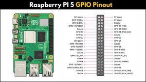

Overview of the RPI 5 GPIO Pinout
Raspberry Pi 5 GPIO Pinout
RPI 5 Pinout
Let’s get familiar with the heart of it all — that 40-pin GPIO header on Raspberry Pi 5.
Even though the Pi 5 is newer and more powerful, the header layout is still very similar to previous models like Raspberry Pi 4 Model B. That’s great news because most accessories, HATs, and sensor modules will work just like before.
Each of these 40 pins has a specific role — some provide power, some act as ground, and the rest can be used as digital input/output or for communication protocols like I²C, SPI, or UART. Think of it as your Pi’s “multi-purpose connector.”
Physical vs Chip numbering
Imp: Please note that there are two ways to refer to the GPIO pins.
  • Physical numbering: This is simply pin 1 to pin 40, counting down the rows physically on the header.
  • BCM numbering (Broadcom chip): This refers to the internal GPIO numbers of the Pi’s processor.
For example, pin 11 on the physical header is GPIO 17 in BCM numbering.
When writing code (especially in Python), you can use either system — but you have to be consistent, or your code won’t behave as expected.
Most diagrams and tutorials use physical numbering for wiring and BCM numbering in code. It’s good to get used to both early on.

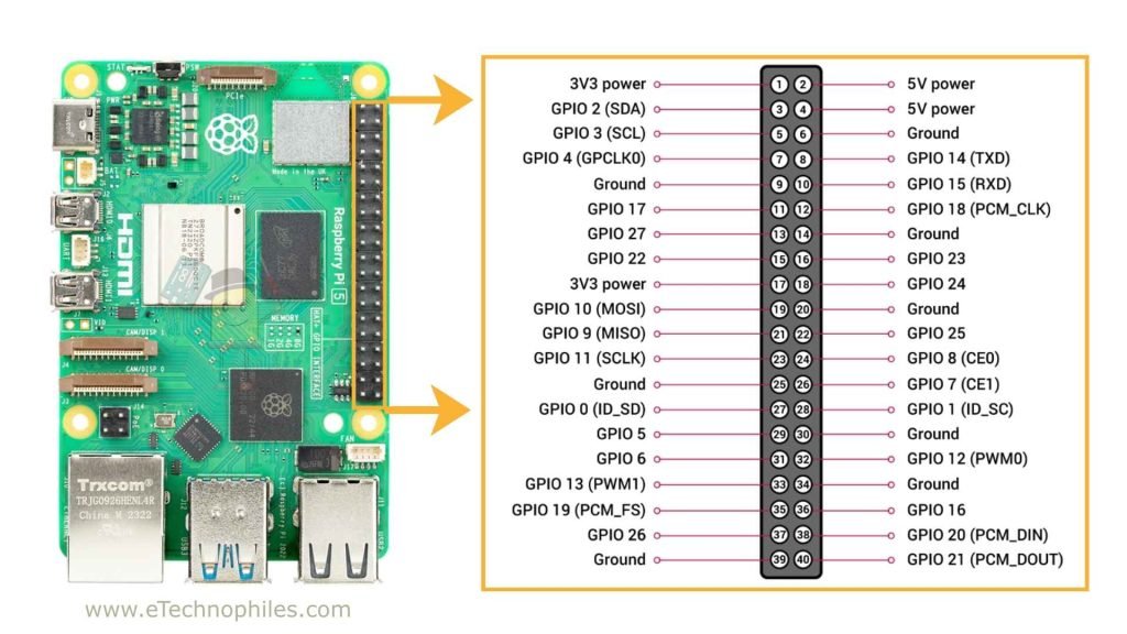

RPi 5 Pin categories & functions
PinNameTypeFunction
13V3Power3.3V Power
25VPower5V Power
3GPIO2I2CSerial Data (SDA)
45VPower5V Power
5GPIO3I2CSerial Clock (SCL)
6GNDGroundGround
7GPIO4GPIOGeneral Purpose I/O
8GPIO14UARTTransmit (TXD)
9GNDGroundGround
10GPIO15UARTReceive (RXD)
11GPIO17SPIChip Enable 1 (CE1)
12GPIO18PWMGeneral Purpose I/O
13GPIO27GPIOGeneral Purpose I/O
14GNDGroundGround
15GPIO22GPIOGeneral Purpose I/O
16GPIO23GPIOGeneral Purpose I/O
173V3Power3.3V Power
18GPIO24GPIOGeneral Purpose I/O
19GPIO10SPI0MOSI (Master Out Slave In)
20GNDGroundGround
21GPIO9SPI0MISO (Master In Slave Out)
22GPIO25GPIOGeneral Purpose I/O
23GPIO11SPI0Serial Clock (SCLK)
24GPIO8SPI0Chip Enable 0 (CE0)
25GNDGroundGround
26GPIO7SPI0Chip Enable 1 (CE1)
27GPIO0I2CEEPROM Serial Data (SDA)
28GPIO1I2CEEPROM Serial Clock (SCL)
29GPIO5GPIOGeneral Purpose I/O
30GNDGroundGround
31GPIO6GPIOGeneral Purpose I/O
32GPIO12PWMGeneral Purpose I/O
33GPIO13PWMGeneral Purpose I/O
34GNDGroundGround
35GPIO19SPI1MISO (Master In Slave Out)
36GPIO16SPI1Chip Enable 2 (CE2)
37GPIO26GPIOGeneral Purpose I/O
38GPIO20SPI1MOSI (Master Out Slave In)
39GNDGroundGround
40GPIO21SPI1Serial Clock (SCLK)
RPI 5 GPIO pin name and function
Here’s a quick breakdown of what kinds of pins you’ll find:
  • Power pins → 5 V and 3.3 V output pins to power your components.
  • Ground pins (GND) → these complete the circuit.
  • Standard GPIO pins → general-purpose pins for input/output.
  • Special function pins → used for I²C, SPI, UART, and PCM communications.
1. Power pins (5 V and 3.3 V)
  • These pins provide power directly from the Pi’s power supply.
  • 5 V pins (Pins 2 and 4) can power components like relays, LED strips, and certain sensors.
  • 3.3 V pins (Pins 1 and 17) are used for most low-voltage sensors and modules.
Note: GPIO logic runs at 3.3 V — not 5 V. So if you connect 5 V directly to a GPIO pin, there’s a good chance you’ll fry your board. If your component needs 5 V but communicates at 3.3 V, use a logic level shifter.
2. Ground pins (GND)
  • Ground pins are your circuit’s return path.
  • They’re located on multiple pins across the header (Pins 6, 9, 14, 20, 25, 30, 34, and 39).
3. Standard GPIO pins
  • These are the “do anything” pins. You can set them as input (to read from a button, sensor, etc.) or output (to control LEDs, buzzers, relays, etc.).
  • Each GPIO pin can be programmed individually.
For example, you can set GPIO 17 (Physical Pin 11) to output HIGH, and your LED will turn on. Set it to LOW, and the LED turns off. Simple as that.
4. Special function pins
Some pins can do more than just act as regular input/output. These are used for communication protocols that let the Pi talk to other chips and modules.
Here are the main ones:
  • I²C (Inter-Integrated Circuit)
    • Used to connect sensors and modules that support I²C (like temperature sensors, OLED displays, etc.).
    • Pins: SDA (Pin 3, GPIO 2) and SCL (Pin 5, GPIO 3).
  • SPI (Serial Peripheral Interface)
    • A fast communication protocol often used for displays and memory modules.
    • Pins: MISO (Pin 21), MOSI (Pin 19), SCLK (Pin 23), CE0 (Pin 24), CE1 (Pin 26).
  • UART (Universal Asynchronous Receiver/Transmitter)
    • Used for serial communication, like connecting the Pi to an Arduino or a GPS module.
    • Pins: TX (Pin 8, GPIO 14) and RX (Pin 10, GPIO 15).
  • PCM / I2S (Pulse-code modulation)
    • Useful for audio projects and digital sound interfaces.
    • These pins overlap with some SPI pins, so you can’t use both at the same time on the same pins.
Note: Many special function pins overlap with standard GPIO pins. That means you can either use them for their special function or as a regular GPIO, but not both at once.
